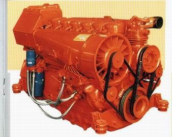

https://img.diytrade.com/cdimg/611433/6701004/0/1219324568/Deutz_diesel_engine_air_cooled.jpg Twisted Evil
